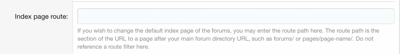

If you want a homepage just create a page node, edit it and then got to Options > Basic board information and edit this:

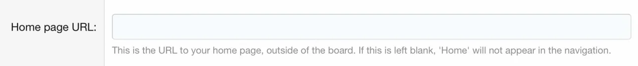

And this:
