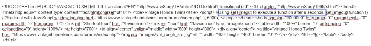

We started with vB 4.5 years ago and upgraded to Xenforo a year ago last August (it's SO much better). The member who helped with the initial setup added a splash page with our logo that timed out after about 8 seconds and then redirected to the main forum page. I now realize from some research that it could be causing our search results to be less than we'd like, so I'd like to either eliminate it or reduce the time out to 1 to 2 seconds, whichever is considered best. I believe I found the file in our server CP to make the change but I'm afraid to attempt it, and I'm not sure exactly how to do it anyway. I have a couple of screenshots but I'm unsure if I should post them publicly. Again, apologies for my lack of knowledge, I'm retired and my field of expertise in my working life was mechanical (vintage motorcycle forum). I'm happy to provide anything asked for to help someone guide me through what to do.

Probably an index.php file with a timed redirect. Can you post the code in the index.php file?
Or else (and this is what I might have done) is to keep the xenforo index.php as is (I don't think it's good to mess with or change name), then make the landing page (e.g. landing-page.html) the directory root (in htaccess DirectoryIndex landing-page.html) and redirect to stock xenForo index.php
So to make it not have time lag and redirect:
From the landing page remove the bit that looks like this <meta http-equiv = "refresh" content = "8; url = https://landing-page.html" />
and remove DirectoryIndex landing-page.html from htaccess
The commented out line says 8 seconds, so it was 8000 at one point and if it still was you probably would have figured it out. 😉
