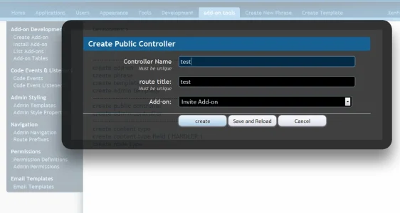

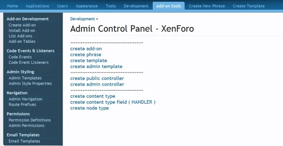

Hm, i'm intersted too, but i'm having & using my own tools for a long time and too many things are "hardcoded"
and include ugly code like:
PHP:
$name = 'Ragtek_' . substr($addOnId, 6) . '_Hashes';
$hashFileContent = XenForo_Helper_Hash::getHashClassCode($name, $this->hashes);
$directory = 'upload/library/Ragtek/' . substr($addOnId, 6) . '/Hashes.php';
    protected function _getPaXXXXX(){
        $structure = '';
        if ($this->_checkIfRagtekAddon()){
            $structure .= "Ragtek_" . substr($this->_addon['addon_id'], 6) . '_';
        else {
            // TODO i need to change this
            die('only ragtek add-ons are supported ATM');
        return $structure;
As i started developing add-ons, i've decided to put all my add-ons into the "ragtek" directory, so it's easier to use my add-ons via symlink for > 30 boards (http://xenforo.com/community/threads/move-config-php-out-of-library-directory.8970/ )
so i'm not able to use https://github.com/Naatan/XenForo-CLI or https://github.com/daohoangson/DevHelper
now it would be a too big "refactoring challenge" to move everything out of the ragtek directory
View attachment 30295View attachment 30296

Actually this is already possible, the "addon add" command allows you to specify the directory the addon is in, so you can have your own namespace directory.
I see you basically had the same "problem" as us, being that some things are just too tedious to do repeatedly. I think having a web interface for it is an interesting solution but it still draws you out of your IDE. Why not join us in developing the CLI and add some of the tools that you are currently missing in it?
A nice side-effect of doing this with a larger group of developers is that you have constant code-review, essentially forcing you to a certain level of code quality. And if you miss something, other developers might catch it.
