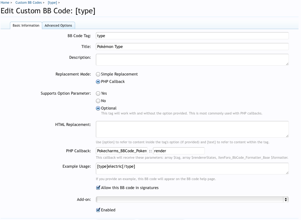

When I use that code and try to render a BBCode: I get the following error:
Call to undefined method XenForo_BbCode_Formatter_ImageCount::getView() in /Volumes/Content/Web/xf/library/Pokecharms/BBCode/PokemonType.php on line 6
My full code is:
PHP:
<?php
class Pokecharms_BBCode_PokemonType
    public static function render(array $tag, array $rendererStates, XenForo_BbCode_Formatter_Base $formatter)
        $view = $formatter->getView();
        if ($view)
            $template = $view->createTemplateObject('type_image', array('content' => $tag['children'][0]));
            return $template->render();

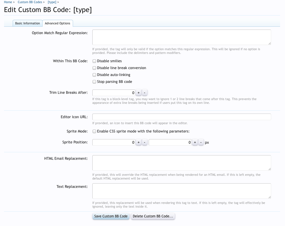

The settings are as follows:
This is a bizarre problem, I can't find out why XenForo is picking up the wrong renderer.
That all looks correct. My immediate thought is if you have an old code event listener related to bb code, or some other add-on now interfering with it.
Assuming that there is no other code behind this bb code other than the custom bb code callback and a template you might even be able to just do $config['enableListeners'] = false; in config.php just to immediately discount any other code causing a problem.
