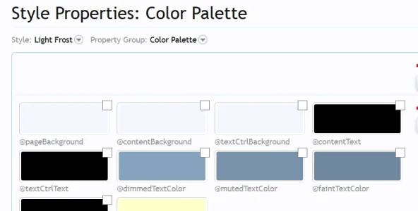

It's basically only color Color Palette changes.
(see attached screen shot)

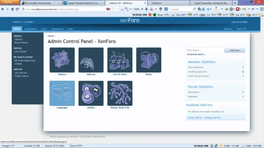

So I imported the old 1.1.4 version into my test site and am told there is zero template changes.
Going over the templates manually and I'm also told nothing shows up as changed.

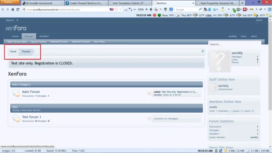

But if you look at the breadcrumbs
You clearly see an error.

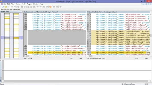

I decided to make an exact copy, manually... ie... Basically rebuild my style from scratch using 1.2. And extract the style that I had imported.
There should be no code changes, because XenForo is telling me they are the same and they are both coming from XenForo 1.2
The yellowish / orange color notes difference (using a program called Win Merge to compare)
( see attached screen shot )
Attached is both extracted from XenForo 1.2 beta 3

The only thing changed is the Color Palette and the font Trebuchet MS.
So the only style properties changes was the font, Trebuchet MS.
But both match... ie... What you find in "Light Styles" you find in my "test style"
You have a style property that is out of date (specifically @breadcrumItemCrumb; it's missing a height). This particular issue will probably be changed so it won't end up being an issue, but it's really the nature of customizing style properties. If you update, your customized versions are kept like templates. In some (albeit rare) circumstances, this can cause problems. To some degree, if problems are noticed, the style properties need to be checked as well.
