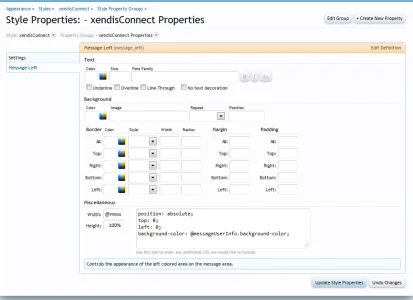

:D, I'm doing an update for xendisConnect now, it'll replace that back part with a div which will fill with the color of your choice, I'll also make it automatically pull the width of the user bit so they'll be less editing for users.

Two things you need to do(next patch addresses the background issue)
Extend the background of that image like previously noted, then style properties -> message layout -> message content, adjust the margin left. It doesn't automatically resize by default if you increase the userblock width.

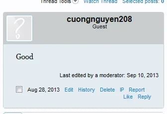

another issue my users are complaining about, since I run the oversize avatar's, they are saying that when viewing in mobile the avatars to do not allow them to view the message windows with more then 1 line. Judging by what im seeing this is partly because of the background image used on the member info box?
I'd need a link to the site to debug that one, by default this is the correct view:
