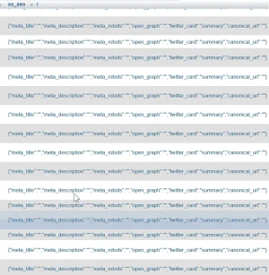

Some minutes ago i have inserted title and text for a thread.
After saving i had the idea to change it.
Funny, funny, there was nothing saved! Also there was no error-message in the acp.
Then i have checked the table xf_thread with phpMyAdmin and funny, funny i have found really a lot of threads with this SEO-Data:
{"meta_title":"","meta_description":"","meta_robots":"","open_graph":"","twitter_card":"summary","canonical_url":""}
Please find out, how this is possible. You may have problems in your script or the script has problems with typical other addons. The forums i have tested the SEO-Addon are demo-forums with less addons, but with all the stuff you typically would use in every forum.
Also please check, why something is saved, when there is no content? Why i should fill the database with
This makes no sense!
