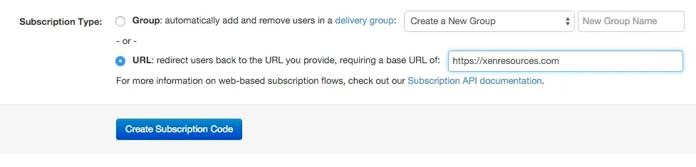

I've went through the steps, and registered the forum. I received a response on my smartphone that the forum is now subscribed to notifications.
When I go back to "External Accounts" on the phone (S4) it shows that I am unsubscribed.
I am receiving alerts on the forum, nothing is Pushing to the phone.
I did try to Push a test message from Pushover's website and that came through ok.
"Associate account with Pushover" is enabled.
All "Alert Types" are currently enabled.
Generally this is caused by this setting when you set up Pushover:
I've seen this happen when "Group" is selected or if the "URL" field is either blank or wrong.
