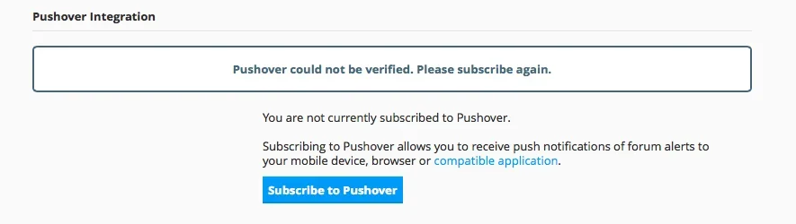

Hi Chris, I'm on Xenforo 1.4.5 (updating to 1.5 maybe in a month or two).
Plugin is installed, Pushover account and app created, keys have been added, permissions turned on via the forum for my user.
When I go to the external accounts page, everything looks great. I then click the subscribe to pushover button.
I get confirmation to my device that I've been subscribed to the application, but receive this error when I return to the forum page.
Any ideas about what I might be missing? Thank you!

You have to download the app on your mobile device, and sign up for an account, then go to the forum and click the subscribe button.

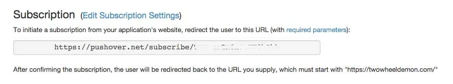

You did (in Pushover site) activate a subscription did you not?
I see you say you installed the add-on, Pushover account and app created and keys added.. but what about the subscription aspect that the new version requires that you set up?
This is from the control panel for Pushover where you set the application up
and put the associated subscription code in the forum ACP for the app?
