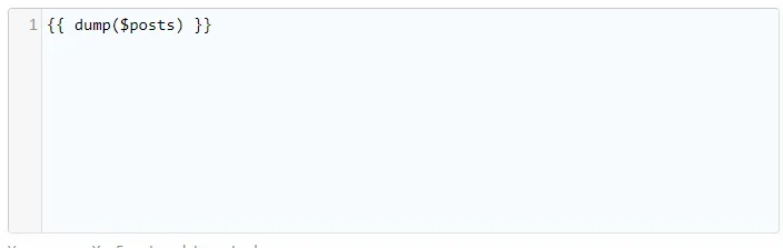

The $posts return null in the thread view sidebar
You need to pass to the context, add this in the thread_view_sidebar position in thread_view template

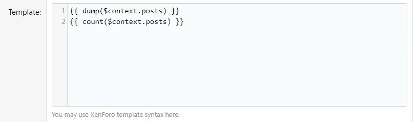

Should be
Rich (BB code):
<xf:if is="count($context.posts) > 2">
<div class="adSense ad_above_content" align="center" style="padding: 30px 0px; border: 1px solid #e4e4e4; border-radius: 5px; background: #3d70d2;">
<div align="center" style="color: #fff;">FMU__thread_view_sidebar</div>
</div>
</xf:if>
