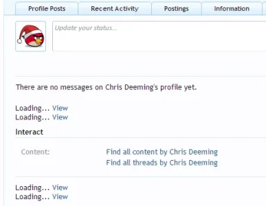

HTML:
<span class="jsOnly">{xen:phrase loading}...</span>
Should be:
HTML:
<span class="JsOnly">{xen:phrase loading}...</span>

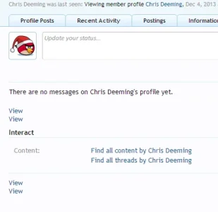

The adverse effect is this:
Vs, this:
Still looks awful. But then that serves you right if you want to browse a modern site with JS turned off :p
These mistakes were actually in a number of templates - mostly relating to ignored indicators. We did actually fix this already, but only in 1.3; I believe because of how minor it potentially is and the number of templates it does affect.
However, the reasonable other approach is to support .jsOnly as well.
