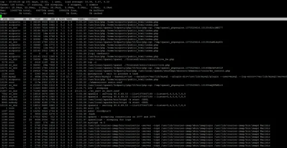

There seems to be no rhyme or reason. At the moment the loads are 0.52 , 2.87, 5.33
But all of a sudden things and can beserk.

Is that at the top of the screenshot I posted yesterday? If so i mentioned this and its since been upgraded.

Thanks Matt. Currently running at 13.24 at the moment! Took another screenshot whilst it was in it way up.

Please post a screenshot of iostat and iotop as well. There is nothing in your top screenshot that is terribly out of the ordinary or that should be causing these loads.
Please stop posting screenshots, paste the real text from terminal.
What is the disk usage? The idle jumps from 89% to 28%, that is not normal.
