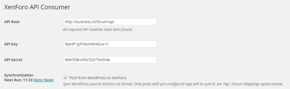

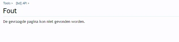

According to this screenshot of yoursMy xenforo/wordpress bridge does not work and i cannot find the solution. tried several things but won't help. Anyone who can help me?
According to this screenshot of yours![]()
It looks like the key/secret is not entered correctly in WordPress settings page. It should read "All required API modules have been found." if you entered correctly. Did you see that message?

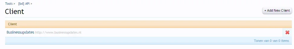

Did you create the new client from AdminCP or from the front end? You should go to http://domain.com/xenforo/index.php?account/api/client-add to do that.I'm sorry but cannot get it done....it's not working. it would be nice to have some help
What is your exact problem? The screenshot indicated no problem related to the bridge?How much money do i need to pay for someone help me out with this problem? I need it to be solved ASAP!
What is the problem exactly? "It does not work" is not helpful in debugging the issue. For example, you can't complete step 3 or something? Please be more specific.Spent more then 100+ hours to get it to work but just cannot get it done.

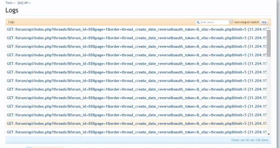

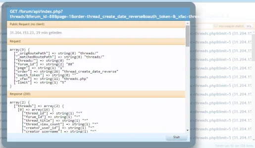

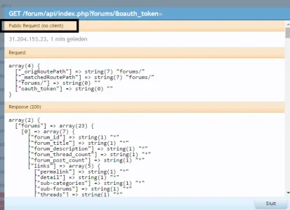

The no client screenshot does not mean anything btw. And the log screenshot is normal too. Not all requests are made with client information.disabled all my addons.....no effect

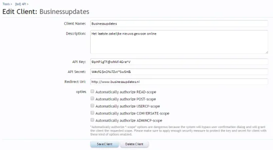

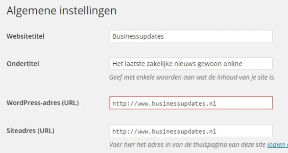

in screenshots
1. client
2. match perfectly with wp
3. api credentials are correct
4. syncronizing.......no client?
also no post from wp to xenforo

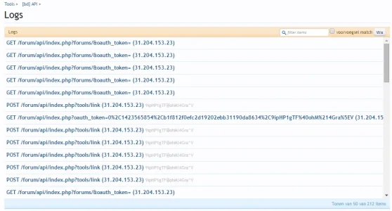

logs
