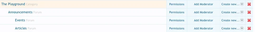

I attatched the image just to make sure that a forum was actually what i thought it was. So if you see the image the Category is "The Playground", and everything under that category is a forum? What im looking to do is to create 2,500 of these forums under One category.

I can't imagine the page would be that usable with 2,500 forums.
How many are going to be siblings (at the same level)?
All of them would be at the same level. So all of them would be on the same level. Im not sure if im explaining this right =/

Alright, it should perform fine. Just uncheck the "display in node list" for each forum to avoid the unfriendly user interface. There shouldn't be any performance issue.
This is what I was told by one developer..
"It is slow because XenForo usually rebuild permission for all nodes when something is changed. It works okie if you have less than 100 nodes and less than 10 user groups (that is about a thousand combination). When you have 2500 forums, that will be 25000 combination and that will be just slow. And because it is slow, the rebuild process sometime stopped half way, leaving you with a corrupted / incomplete permission table. Also, having that many forums may kill the caching because the data is too big."
Avoid making changes to the permissions of the forums in that category and you won't trigger the rebuild. It's kind of like, once you get it set leave it, type thing. Obviously some processes such as getting board stats and what not will be a little slower. The caching should be fine. You may have to increase the timeout limits. You may run into issues on shared hosting with limited resources. I'm not saying it's going to perform like it would if you only have one node but you should be able to run it fine. The server isn't going to fry trying to run your site or anything.
