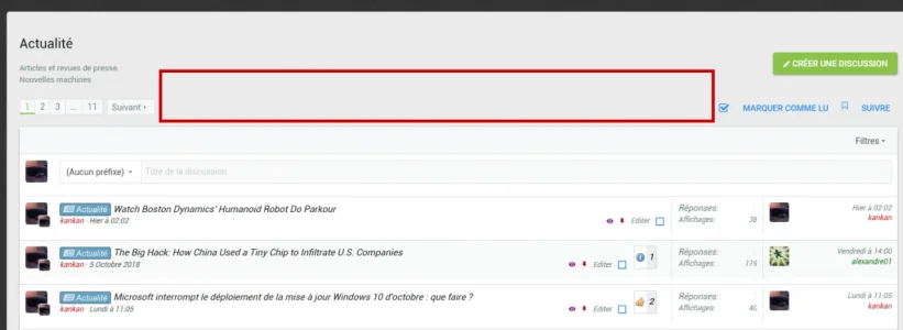

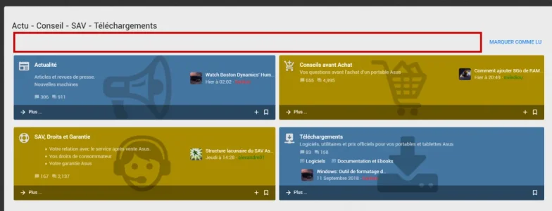

Did you find a solution ?
May be :
$thread_id == x
