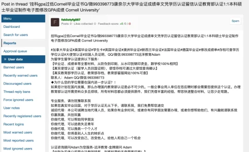

Without seeing a message, I am assuming they are using full-width (CJK - Chinese, Japanese, Korean)
你應該嘗試一下這種叫做 MEDS 的新藥
I'm unsure how you could put this into a regex for the spam filter to pick up on them, but it would reject full-width upper/lowercase and numbers.

Here is a typical message

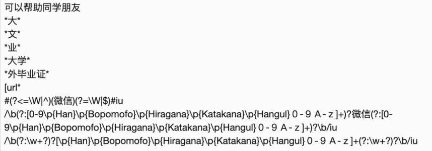

Here you can see my attempts to block it in Spam Phrases
Perhaps you can send "QQ" to moderation. That seems like the route they want to be contacted by.

/[一-龠]+|[ぁ-ゔ]+|[ァ-ヴー]+|[々〆〤ヶ]+/u
Is what I use and nothing ever gets through..
