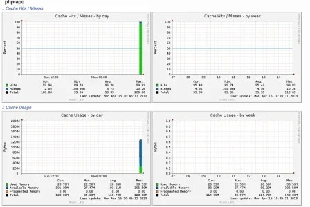

Mind to share your found solution about munin, Tracy Perry ? Yes, I'm exceptionally lazy to search. :P
Mind to share your found solution about munin, Tracy Perry ? Yes, I'm exceptionally lazy to search. :p
This is for using nginx - so here we go.
In /etc/munin/plugin-conf.d make a file called php_apc and place
[php_apc_*]
user root
env.url http://localhost/apc_info.php?auto
in it.
Define a localhost for nginx with
server {
    server_name localhost;
    include /etc/nginx/php.conf;
    root /usr/share/nginx/html;
    allow 127.0.0.1;
    deny all;
    location / {
    access_log off;
    location /nginx_status {
    stub_status on;
    access_log off;
In the ROOT defined above create a file called apc_info.php that contains

Create a file called php_apc_ in /usr/share/munin/plugins containing
#!/usr/bin/perl
# Magic markers:
#%# family=auto

at the command line issue
chmod -R 755 /usr/share/munin/plugins/php_apc_
ln -s /usr/share/munin/plugins/php_apc_ /etc/munin/plugins/php_apc_usage
ln -s /usr/share/munin/plugins/php_apc_ /etc/munin/plugins/php_apc_hit_miss
ln -s /usr/share/munin/plugins/php_apc_ /etc/munin/plugins/php_apc_purge
ln -s /usr/share/munin/plugins/php_apc_ /etc/munin/plugins/php_apc_fragmentation
ln -s /usr/share/munin/plugins/php_apc_ /etc/munin/plugins/php_apc_files
ln -s /usr/share/munin/plugins/php_apc_ /etc/munin/plugins/php_apc_rates
You must have libwww-perl installed.
I think that covered everything. ;)
Oh, forgot to mention - issue an /etc/init.d/munin-node restart. :rolleyes:
It will look somewhat like this - in addition to fragmentation, purge rates and files in cache.
