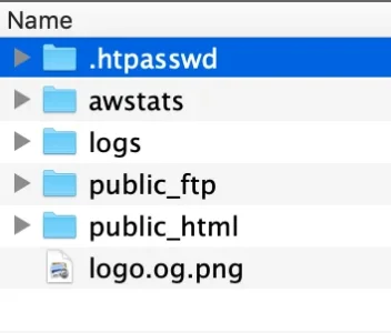

When i read all the instructions i know i have to copy the files to my FTP in the root, but here it is a bit different.
My list looks like the screenshot i made and attached to the post.
Do i put the files in the root or in the public_html folder where all the Xenforo files are stored? I think i put it in the public_html folder.
I can't seem to find any related posts about this.

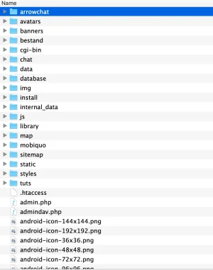

This is the content of the public_html folder
"The root" doesn't mean the root on your server.
It means the folder where the forum is installed. In most cases, including yours,this is public_html.
While you're upgrading, uninstall Tapatalk and then you can delete the mobiquo folder.
Yes, that should be done. The forum is copied to a other server now en runs on Xampp. I think i will updated the software to 2.x this weekend and run a test. If all goes well i will move the forum to the new server and update the live software.
