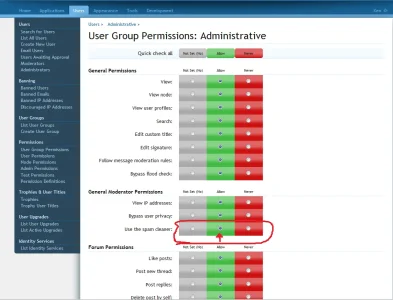

In the ACP-
Users--> User Group Permissions: --> Administrative
Set: Use the spam cleaner to allow​

its set to allow
i even tried to add specific user permission to allow spam cleaner, but even after that link "spam" isn't appear

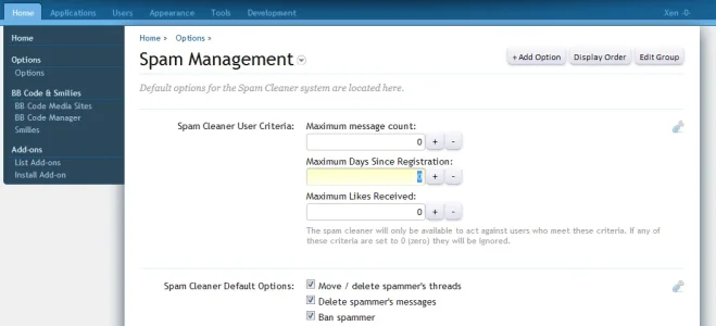

try...
In the ACP
Home --> Options --> Spam Management
At the top find this
Spam Cleaner User Criteria:
  • Maximum message count:
  • Maximum Days Since Registration:
  • Maximum Likes Received:
set all of these values to 0
EQnoble
You will have to make a test user if you are on a new install and post as a test user as I don't think the forum would allow you to mark an administrator's posts as spam just to throw that out there. :)
