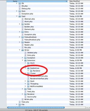

And here is a screenshot of contents of the zip archive
There is no such file...

open_basedir restriction in effect
This is an issue with your server configuration, unfortunately. There are a couple changes here, but most likely your PHP include_path has a value that is outside your open_basedir, which doesn't really make sense to be honest.
That is simply how this particular ZF component works.
