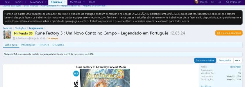

When you create a Resource, a Discussion topic is created.
You can use the navigation tabs to switch between Resource, Information, Historic, and Discussion.
But when you change the type of a node from Discussion to Article, for example, the navigation is lost. I wanted to change it to Article to test and see if the topic view was better. It was a test.
But when you change the Node back to Discussion, the old navigation is not recovered. The layout is lost when you click on Discussion. It is as if you left the Resource.

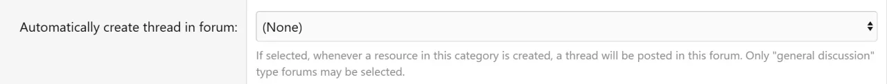

I understand. But the problem is that the topics disconnect when changing and do not reconnect automatically, even if they are linked in the option. You have to remove the topic, save, add the topic and save. And do this for all resources.
