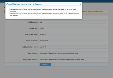

i seem to be stuck here with the paths when importing xf 1.15.15a to the latest unsupported version of xf release candidate 3.
I have re-written the files and everything. But when merging the whole thing it doesn't want to do it for me.
What paths do i put in to the data and internal data things because the ftp urls aren't working and it is causing me to be frustrated?

You can’t import files remotely. They have to be on the same server.

they are on the same server.
With your second comment that's what i thought. It's kind of a bit strange. How are we supposed to bring all of our members and that over to the new version if you can't import from the one you are on?
We can't even import to any of the xenforo beta ones.
If they're on the same server, you don't need to use FTP. You'd just define the actual path to them on the server.
e.g. /path/to/your/httpdocs/forum/data etc.
