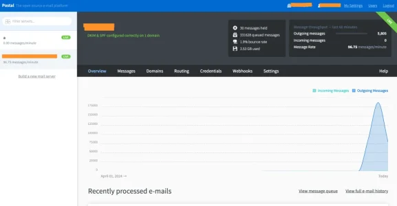

At the moment we are testing Postal with the largest of forums.

Screenshot:
330k+ queued messages

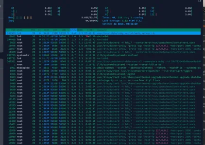

htop shows that the server is barelly loaded:

Screenshot:
