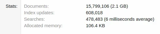

I have a similarly sized site, 1.5 mil posts, but not as active as it once was in the hayday.
i run a 4gb / 2 core vps with ES on the same machine.
Documents 1,460,892 (263.1 MB)
Index updates 70
Searches 4,795 (1 milliseconds average)
Allocated memory 956.5 KB
shouldn't this value be larger than documents?
Index updates 70
for me it's
Documents    1,391,184 (770.9 MB)
Index updates    1,518,628
Searches    17 (11 milliseconds average)
Allocated memory    68.8 KB
my allocated memory also is very low compared to yours. is this connected to values configured in ES settings? :confused:
