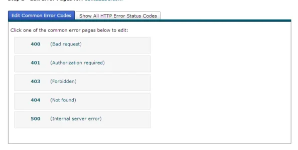

No, you need to create a 404 error page to serve. In the pictures I posted, click Error pages, then click the 404 (not found) one. You can then make an error page inside cpanel, and it will stop those error messages about 404.shtml not found
I fixed some code in a template of mine (the theme error above) and when I checked the error log, everything's gone. Does that mean I don't have to bother?
If I do, would you mind walking me through how to configure the 404 page please? Its got 6 options and I have absolutely no idea how to work that out.
