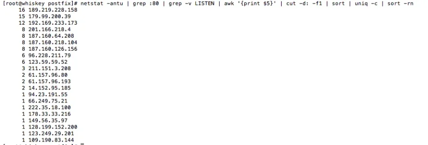

Check your logs and see how much traffic is hitting it. As popular as it is now for the PITA's (Pain in the Asses) to do, frequently I see DDOS attacks against random sites. Typically it's a WP Pingback attack.
If you are on a VPS, you can also (from the CLI) see how many active connections you have by
netstat -antu | grep :80 | grep -v LISTEN | awk '{print $5}' | cut -d: -f1 | sort | uniq -c | sort -rn
Here is an example from my server
If you see an unusually high number, especially from certain IP's, then you probably have issues. If you run SSL on the site, you can also check port 443 by replacing the grep :80 with grep :443
