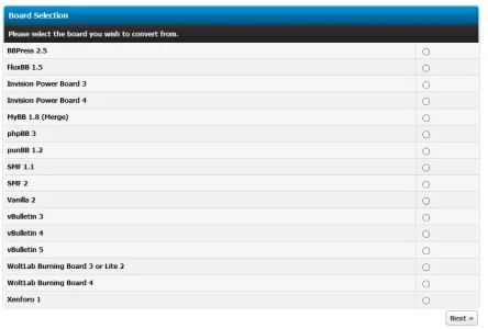

@demon326 I am trying to migrate from Waltlab Burning Board 5.0.20 to Xenforo 2 . I am following your given steps But unable to find the option for Burning Board 5 (find attachment). Is there any option that i am missing or anything else?
Use the Wolt Lab 4 button, the code has been modified to work with 5. Atleast it worked like that about 6 months ago :)

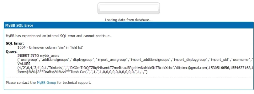

I have tried Wolt Lab 4 button . But when i am trying to import users it shows me this error(find attachment).
It says that it cannot find the colom 'aim' in the users table on the mybb install thus it cannot insert the data..
You can try to run is query on the mybb database as a workaround:
ALTER TABLE `mybb_users` ADD `aim` VARCHAR(50) CHARACTER SET utf8 COLLATE utf8_general_ci NOT NULL DEFAULT '' AFTER `icq`;
It should work then... The issue is because i used al older mybb version, prior the removal of aim that happend in may 2018:
If that does not work, download an older mybb version and do a clean install.
