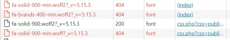

Use your browser inspector:
Nope, I'm sorry to tell you, but I checked your site. The minimized fonts give error 404 which means they are not there at all.

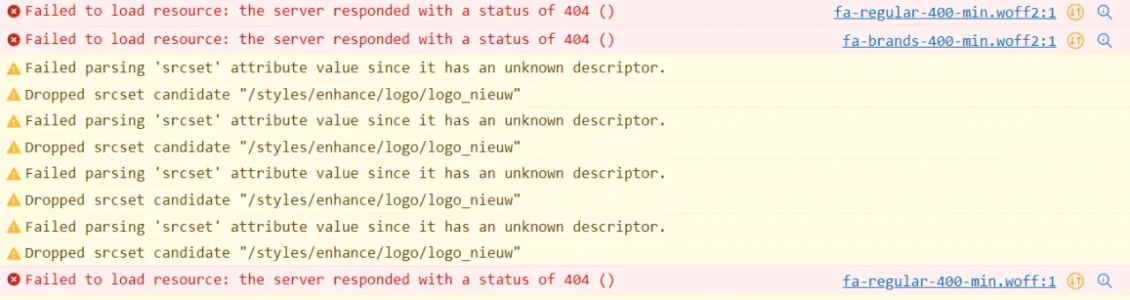

It is still loading the normal font awesome files. Check the errors in your browser console.
The red files are minimized files, which are not loaded because there are not compiled correctly.
The fa-solid-900.woff file is the normal font, so that's not good :)

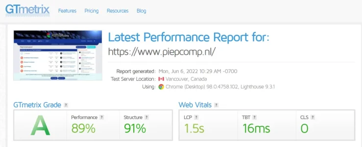

Oddly though, we use Kirby's FA add-on on all of our sites, none of which has any missing font files as a result. So I'm thinking there is something else going on with your site not related to Kirby's product.
