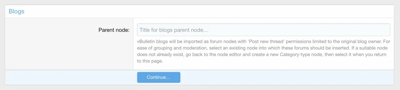

The "Blogs: Parent node" config option says you should create a Category node for blogs to be imported into. However, when doing so and submitting the page, you get this:

The description makes no mention of the fact that Retain IDs cannot be selected when you follow the instructions.
Furthermore, I think this node should be created automatically based on what you enter in this field, AFTER every other forum has been imported, so that retain IDs can be used.

You imply that it's necessary to manually create a node, but if retain IDs is enabled, you actually create the node in the importer step UI:
There's potentially a mistake in the explain text. I guess it's possible that you didn't realise this page would create the node for you?
That could very well be the case, from reading the text in the screenshot I would definitely have assumed that I needed to create a node first, then select that node on that page.
What is still unexplainable is how I managed to trigger that exception in the first place, I know I wouldn't have edited the HTML source to allow me to tick the Retain IDs box.
Could it be possible that v1.0.1a / whatever was the current version of XF2 back in the start of April had a bug where creating the node via that input box would trip up the canRetainIds check (and/or that this potential bug still exists)?

So you would have clicked Retain IDs as you intended, and then got the above screen and then have gone back to create the node as the explain text asks you to. After doing that, at the point at which we verified retain IDs would be usable, there would now be a third node which (rightly) makes the retain IDs verification fail as having the extra node would indicate that there may be existing content in the database.
So the mistake seems to be entirely in the explain text. We've changed the explain text to:
vBulletin blogs will be imported as threads. Type the desired name of a new node into which these threads should be inserted.
I think the text displayed in my screenshot is actually from an older implementation and we forgot to update it.
I think we can call this fixed, on that basis.
