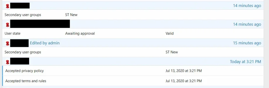

I want to assign all newly registered users to a secondary group. I thought promotion using 'awaiting approval' state would work. Log shows it worked and promotion value given. After approval, secondary user group is removed.
The wording is "Apply this promotion while...", so it seems syntactically correct that while 'not' in approval state anymore, the promotion wouldn't apply.
Is this indeed why the secondary group was removed? I don't see a "apply this promotion when" option.

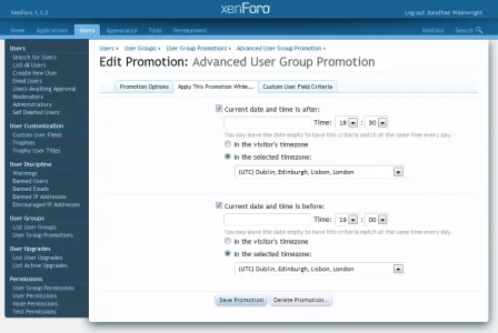

You could do it with this add-on and option #1 (see pic).
