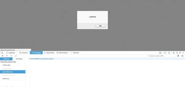

I even tried with the temp mod disabled and nothing else in my js file apart from:
alert(XenForo.phrases.day3);
..but it still displays as "undefined" in the alert window...

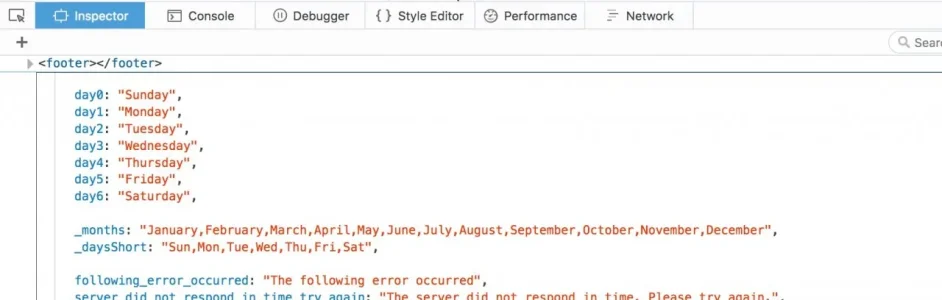

The content of the page_container_js_body template should be visible if you use the element inspector in the browser or View Source:
If the phrases appear in there, then you ought to be able to use them.
Also, of course, check the Console tab for any errors as this can sometimes be an indicator of issues with JS.

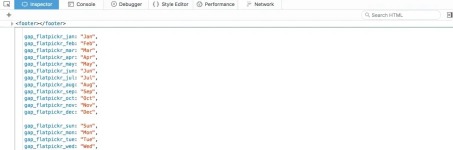

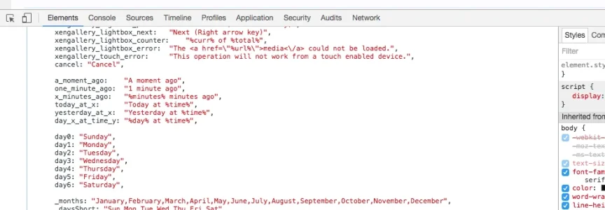

OK, I've been having a look and all the phrases appear in the inspector...
Screen Shot 2016-09-03 at 11.16.07.webp Screen Shot 2016-09-03 at 11.16.29.webp

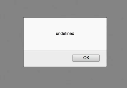

...but they all display as "undefined" in the alert window...
The console doesn't have any errors either and the files appear to be loaded when viewing the debugger.
I've also tried adding the js file to the forum_list to see if the alert will work there, but the phrases still return "undefined" and that's with my temp mod disabled and using the XF defined phrases, eg: day1, day2, etc.
