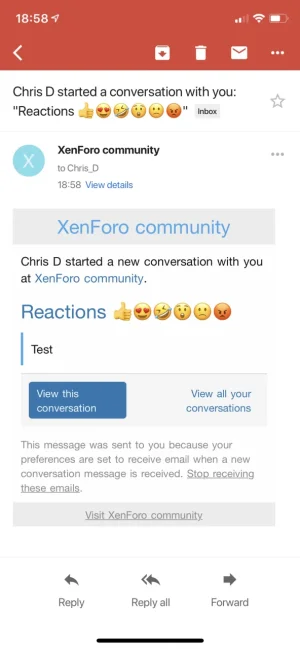

Does this happen with default XF emails too? Such as if you receive a conversation containing an emoji?
We don’t do anything to block them so this is either something on your client, server or within your add-on:
There is a difference between encoding the content and encoding the header lines (subject). You are encoding the content correct for sure, otherwise many foreign language users would have complained.
You would need to test with special characters in a subject to be sure of a correct encoding. But I am also sure it works as it should with regular notification emails.
