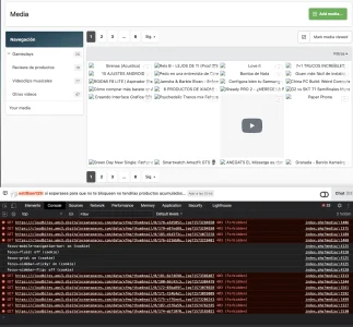

I have problem with tumbnails and avatars on 2.1
images attached to publications look good, but the avatars and thumbnails in the gallery don't work
I think it's because of the cache, I was able to fix the thumbnails in the gallery by regenerating the miniatures
but I don't know how to do this for the avatars
the links of the avatars are like this
