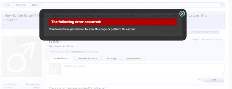

I've just registered on your site and this is the message I see when clicking the avatar location from my profile:
The following error occurred:
You do not have permission to view this page or perform this action.

It's still sounding (and looking from the screenshot above) to be a permission issue.

I've already taken a look and solved it :P Upload size was set to 0.
