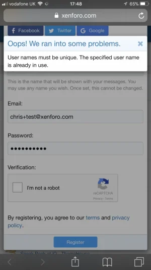

I just tried this and got the "user names must be unique" overlay as expected. I'm not sure what would cause this other than something outside of XF.

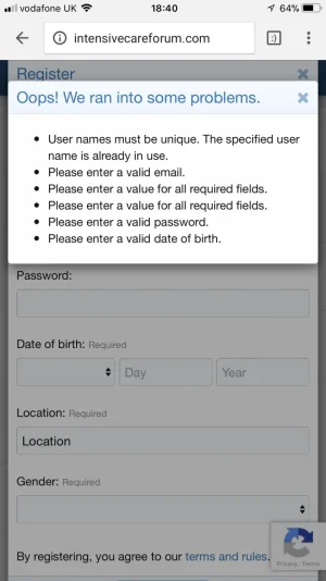

Its not reporducable on xenforo . The alert is coming . But here captcha is not used on registration page . I am using recaptacha.
i have tried every combination . its not coming . also i haven't used any addon. let me see if i can find out anything more.
I don't believe it to be CAPTCHA related. We do have one enabled here but it's the new "invisible CAPTCHA".
For testing's sake, I've re-enabled the traditional version of reCAPTCHA if you'd like to give it a try. Personally, I still can't repo this.
