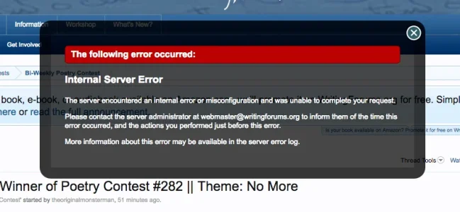

Okay, so I'm having an issue where specific content in a specific forum is triggering a user-sided error without an admin error log.
One of my members is a moderator in a specific sub-forum. They attempted to create a new thread (with a prefix) but received a server error, not letting them post. This error was only displayed to the user, no admincp log.
An administrative user tried the same thing, received the same pop-up general server error. However, the problem extended one step further for that administrator, they said it "booted them from the site completely" and that they now can't access the site (I'm not sure if this means logging in or to what extent).
The error they see looks like this:
I've examined the admincp error logs and there are no reports. I was able to replicate the error with the same post content. I tried disabling all add-ons. The error still appeared, still with no server error log.

I can't really comment on why it wouldn't let anyone access the site. That error isn't directly coming from XenForo, so it's hard to say if XF is actually involved. The error is coming from your web server (Apache), though it could potentially be a PHP crash.
Realistically, you'll need to look at the Apache error logs as there should be more details logged there. Depending on the error, it's possible it won't actually be logged in your site's error log, but the global Apache log (unfortunately).

The directory's PHP error log and cPanel per-site apache log were clean, but the global Apache error log turned up the correct logs:
[Tue Mar 21 18:37:59.739748 2017] [:error] [pid 23434:tid 139714992523008] [client MY.IP.ADDRESS] ModSecurity: Access denied with code 500 (phase 2). Pattern match "((alter|create|drop)[[:space:]]+(column|database|procedure|table)|delete[[:space:]]+from|update.+set.+=)" at ARGS:message_html. [file "/usr/local/apache/conf/modsec2.user.conf"] [line "254"] [id "300015"] [rev "1"] [msg "Generic SQL injection protection"] [severity "CRITICAL"] [hostname "www.mywebsite.com"] [uri "/weekly-poetry-contests/similarthreads"] [unique_id "WNGrR0PjmgsAAFuKFgIAAAGF"]
[Tue Mar 21 18:38:06.848225 2017] [:error] [pid 23273:tid 139714942166784] [client MY.IP.ADDRESS] ModSecurity: Access denied with code 500 (phase 2). Pattern match "((alter|create|drop)[[:space:]]+(column|database|procedure|table)|delete[[:space:]]+from|update.+set.+=)" at ARGS:message_html. [file "/usr/local/apache/conf/modsec2.user.conf"] [line "254"] [id "300015"] [rev "1"] [msg "Generic SQL injection protection"] [severity "CRITICAL"] [hostname "www.mywebsite.com"] [uri "/weekly-poetry-contests/create-thread/preview"] [unique_id "WNGrTkPjmgsAAFrpskUAAAEL"]
PHP Warning:  PHP Startup: Unable to load dynamic library '/usr/local/lib/php/extensions/no-debug-non-zts-20131226/memcache.so' - /usr/local/lib/php/extensions/no-debug-non-zts-20131226/memcache.so: cannot open shared object file: No such file or directory in Unknown on line 0
[Tue Mar 21 18:38:09.804334 2017] [:error] [pid 32637:tid 139715107710720] [client MY.IP.ADDRESS] ModSecurity: Access denied with code 500 (phase 2). Pattern match "((alter|create|drop)[[:space:]]+(column|database|procedure|table)|delete[[:space:]]+from|update.+set.+=)" at ARGS:message_html. [file "/usr/local/apache/conf/modsec2.user.conf"] [line "254"] [id "300015"] [rev "1"] [msg "Generic SQL injection protection"] [severity "CRITICAL"] [hostname "www.mywebsite.com"] [uri "/weekly-poetry-contests/add-thread"] [unique_id "WNGrUUPjmgsAAH99UEAAAAHA"]
There are additional error logs related to the site that I will need to investigate, but they aren't time-correlated to my recreation of the error. Which is still only caused by adding the smilie to the same original post, by the way.
Obviously this appears to be some sort of "generic SQL injection protection" but I haven't the slightest idea why a smilie image would trigger it. Overzealous modsecurity settings? But why the smilie?
