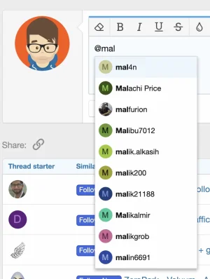

It would be awesome if the add-on sorted by the usernames shown by how many posts the users have. For forums with a lot of users, it would be much easier to use if you sorted by total posts since those are probably the people you are trying to mention :)
Replacing how username matching works is something on my to-do list. It would likely be part of ElasticSearch Essentials since a lot of the username matching limitations come from how it queries MySQL for usernames.

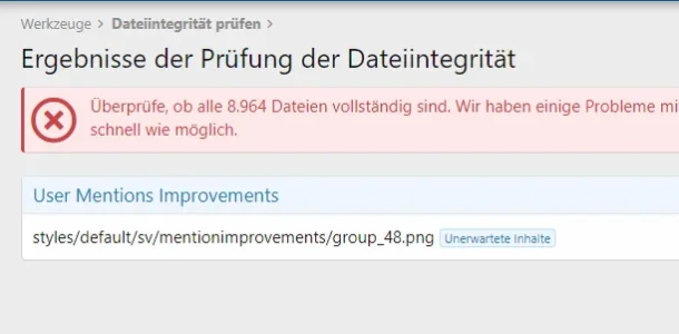

I got an error in the file check system on a custom avatar for a group. How can i fix this?
I'ld recommend copying the file you changes, and updating groups to use that instead.
You would need to re-upload the add-on to update the file, or just edit the hashes.json file to remove the reference. But updating the add-on will update the hashes.json & image file.
