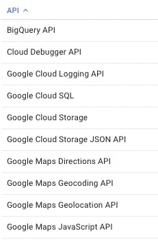

Can you display the best practice which API I need. I just realized I had multiple stuff activated but I think not everything is needed, right?

Bottom one, Google Maps Javascript API, is all you need.
Thanks, I was confused about that as well, that's the one I chose. Unfortunately it was giving me an error that I couldn't figure out so I deleted the key (don't need it) and the error went away. It was related to https usage on my site. So the bottom line is that you don't need the key, even the free one, on a smaller forum - just leave the field blank. For me who is not really savvy when it comes to Google APIs and keys, it was kind of a pain to get it set up
