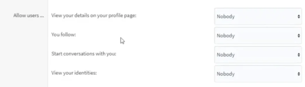

These are the privacy settings for the user from the video:

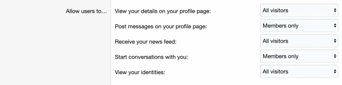

Notably the actual software privacy settings are different from the video:
I'm assuming you have profile posts disabled and I'm assuming you have the news feed disabled so the only entries I'd expect to see here by default are:
  • View your details
  • Start conversations
  • View your identities
All that being said, I do not know what "Allow users ... You follow: Never" means or where the "You follow" option comes from. Is it an add-on? Is it designed so that a user can control who is allowed to follow them or not?
If so and that's what the report is about I think you need to report the issue there as it is not default functionality in the software.

All that being said, I do not know what "Allow users ... You follow => Never" means or where the "You follow" option comes from. Is it an add-on? Is it designed so that a user can control who is allowed to follow them or not?
Our website is in Dutch. The reporter who performed the audit translated the website with his browser, and some Dutch words have been translated wronly.
Ok. In that case, I'm not exactly sure what the bug that is being reported is.
Nothing shown in the video relates to those privacy options, or demonstrates any information being leaked.
