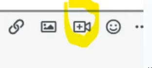

If a member uploads a .mp4 video using 1588595092707.webp when they write a post the video loads fully and is viewable on all browsers on devices using iOS

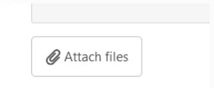

However if it is uploaded it as an attachment using the 1588595075567.webp button, the forum code adds a reference to the file and browsers on iOS can't read that ..

The "Insert video" button is actually the same as the "Insert image" button and the "Attach files" button but it just changes which extensions are allowed to be selected.
All of the code involved in the uploading of the files is otherwise the same.

Video uploaded as an Attachment but not inserted into post

The issue is when a member uses the 'Attach file' button to upload the video but then doesn't insert it into the post once it is uploaded.
What seems to happen is if it is not inserted the video is not moved into the relevant 'data' folder but remains sat in limbo as an attachment with a file reference that iOS cannot read.
Here is the before and after link using the 'Attach file' button on our forum, and then using the option to insert video:
Attach only: https://www.maggotdrowning.com/forums/index.php?attachments/31793-mp4.32279/
Attach and insert: https://www.maggotdrowning.com/forums/data/video/32/32280-6a67b45e0cd87682ef8b5cf9b9582158.mp4
