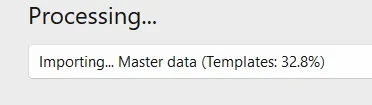

I am currently doing a test upgrade on my laptop, So far it has been running a couple of hours and it is currently at this stage
194692
Does anyone have any idea how much longer it may take?
Also is it likely to take this on long on my live site, I can't remember previous upgrades taking very long at all?

That would be an unusual and unexpected amount of time generally.
Is it making progress past 32.8% or has it been stuck at that exact spot for a couple of hours?
If it is stuck and doesn't appear to be making any progress, you may want to see if refreshing the page in your browser causes it to progress.
The speed here is probably more indicative of the speed of your laptop and/or the MySQL configuration you have with it. Presumably your production MySQL configuration is more optimized for InnoDB.

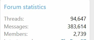

With those stats, I certainly wouldn't expect hours. Even 15 minutes would seem to be fairly long, though not outside the realms of possibility.
I'd say so ;)
It's worth noting that in terms of the process that is taking a while, it shouldn't inherently be much slower than, say, a much more minor upgrade. So, generally, as long as your production server doesn't exhibit the same issues normally, I don't expect the 2.1 upgrade will trigger anything like that for you.

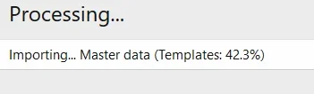

I guess you just have to now weigh up whether it's easier to just wait for this to finish, or start trying out an alternative. As Mike says, you'd generally expect the entire upgrade to finish way within 15 minutes. Your forum isn't too unwieldy in size, and doesn't appear to have a complicated style so I'd agree that even 15 minutes is too long.
You'd likely be at the bit that takes the longest (importing/rebuilding templates) so assuming you're getting slightly closer to 50% completion of that then I'd assume it would be running for another 2+ hours.
Which is really just an unacceptable amount of time (it already is).
