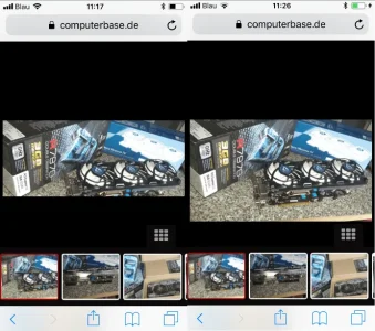

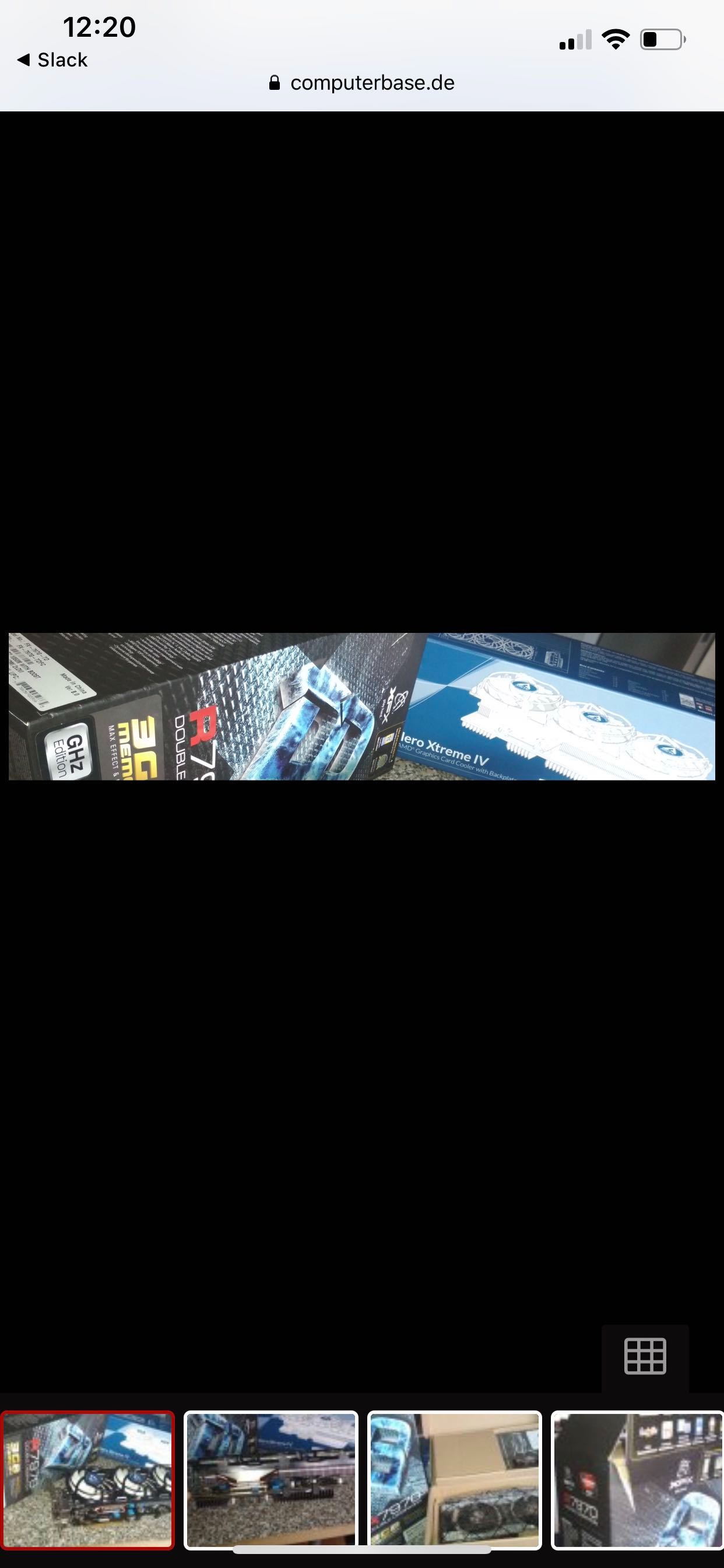

Unfortunately, the image gallery used by XenForo (lightGallery) doesn't only seem to have blurry rendering issues on Android, a broken back button behaviour and erratic pinch-to-zoom-support. It also seems to sporadically crop images on iOS / Mobile Safari. :(
Similar to the blurry rendering issue on Android, this bug isn't reliably reproducable (maybe the issues even have the same root-cause because in both cases the image rendering seems to be interrupted prematurely). For example, I cannot reproduce it in BrowserStack but (in addition to the report by one of our users) it was confirmed by a member of our team on an iPhone 6 running iOS 11.3.1. The original bug report (which is in german but there is a screenshot attached that shows the bug) links to a test-page which unfortunately is in a semi-private forum. I've asked the user whether he'd be fine with posting these images in a public thread but... on the other hand... does a bug-report in lightGallery really make sense anymore considering that this project seems to be more or less abandoned?
I think the only future-proof course of action would be to replace lightGallery with something better. As @Chris D already said in one of the other threads linked above, the popular alternative PhotoSwipe doesn't seem to be well-maintained either (no commits since February, 400 open issues). Maybe fancybox could be an alternative? It's working fine for me on Android, the back button works and it has really smooth pinch-to-zoom support. :unsure:
Edit: I've attached a screenshot made by the mentioned member of our team. Left: when gallery first opened, Right: after swiping to other images and back again

Saying for sure whether the problem only or preferrably exists with larger images is difficult because it only happens sporadically. I've created a post with 5 large images (3840 pixels wide) and a post with 5 smaller images (800 pixels wide) for testing purposes. So far, two users were not able to reproduce the issue at all. One was able to reproduce the issue on first try with the large images (screenshot) but not on second or third try, although he cleared his browser cache (so it's unfortunately pointless to try with the smaller images). I've asked another iPhone user for help who says he sees this problem quite often.
That being said, there is another strong hint that this bug is timing-related: It seems like the same issue was reported to the lightGallery developers about one year ago (images cut off at bottom sometimes until swiping all the way through gallery). No solution was found but the reporter said: "It appears to be a problem when either the server or the client has a slow connection". The filesize impacts such timing-related issues ("race conditions"), too.
It's complicated but I think it's relatively clear that this is a timing-related issue and therefore influenced by filesize, connection speed/latency and probably also CPU speed. Unfortunately, I myself can't reproduce it (and you said you cannot, too), at least not reliably. In combination with the lack of development happening on lightGallery, this makes it a very difficult problem to solve. Considering the other lightGallery issues, I therefore think that it could maybe make more sense to look for alternatives like Fancybox.
The iPhone user who is able to trigger the issue relatively often says that the issue sporadically happens with the small as well as with the large images. It seems to be random.
