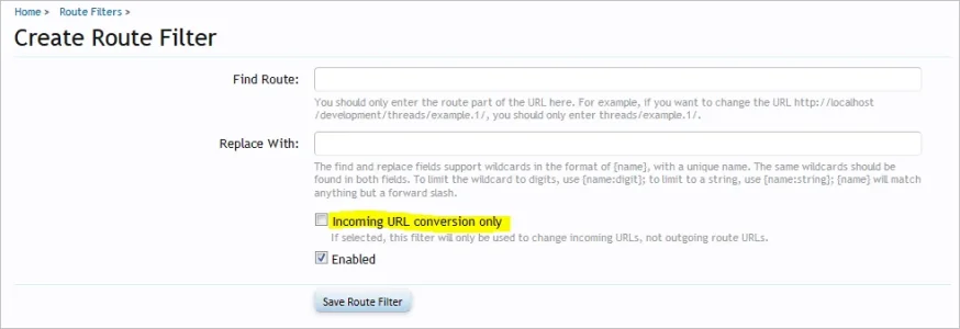

XF 1.4 Undoing a forums/ to f/ route filter
I initially set up my xenForo with a route filter from forums/ to f/. I decided I may like to undo this, so I changed the route filter to f/ to forums/. However, it did not work, and f/ was not redirected to forums/. Why is this, and is there no way to undo this setting without all the page errors?
You should be removing the route filter as best as I know it. Default routes don't get route changed TO.
Edit. For seo and link reasons you would have to follow up with an htaccess redirect or the like. There is no fixing the decision in the software.
The route filter changes default routes to custom ones. Yes it performs a redirect for existing links. But it isn't for redirects back to the original route. If you want the original route I am 99% sure you remove it and as far as redirects go you must do it the old fashioned way.
The route changer just alters the way the route filter in xenforo works. The route for forums is forums. So when you remove the route change to f, f no longer exists and you can't have both because you would create an infinite redirect.
