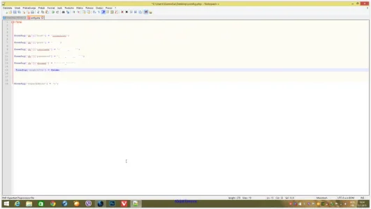

And after @Chris D suggested
 $config['enableTfa'] = false;
here XF 1.5 - Two-Step Verification and Security Improvements got another problems with error.
Parse error: syntax error, unexpected '$config' (T_VARIABLE) in /home/ateist/public_html/klub/library/config.php on line 1
Rather than disabling 2fa, it might be worth trying to solve the actual problem.
My initial suggestion was that the time could be incorrect. Is the server time and time zone correct?
If it isn't please adjust and try again.
The config error. This is simply a case of some sort of error you've introduced while editing the file.
Use a proper text editor like Notepad or Notepad++. Make sure it is added to the bottom of the config.php file.
Your config file looks correct so it is likely something malforming the file. Try a different editor yet again on a copy of the config file copied from your live site (adjusting the credentials accordingly). Also try uploading with a different FTP file.
