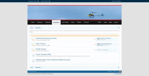

I've decided to try to build a XF style which will match the Twenty Eleven WordPress theme. I have the max-width set to 1000px and this works fine. Now I just want to get the header to look like the WP theme.
Has anyone done this already?
I don't want to recreate the wheel - so - if someone has already done an twenty-eleven theme for XF then please let me know.
My biggest issue is getting the navigation bar hover correct.

Screenshot
You can see it in action here:
http://www.tuxreportsdebates.com/community
Please let me know if you have any ideas on how to improve the look of the navigation links.

A quick bit of tinkering in firebug that might work.
#headerMover #headerProxy {
    height: 205px;
#navigation .pageContent {
    height: 55px;

You shouldn't set a height for .pageContent, that might come back and bite you in the behind for users using some of the lesser browsers (IE). Besides, the height of the elements in navigation does not matter that much, cause they won't overlap anything as long as you set the height of headerProxy, which will basically control the height of the entire header.
If you want to position the quick search below the navbar, correct the top rule of that instead:
#QuickSearch {
display: block;
position: absolute;
right: 20px;
top: -18px;
margin: 0;
background-color: #FCFCFF;
border-radius: 5px;
-webkit-border-radius: 5px;
-moz-border-radius: 5px;
-khtml-border-radius: 5px;
padding-top: 5px;
_padding-top: 3px;
z-index: 7500;
Changing the top: -18px to top: 10px; seems to position it nicely.
