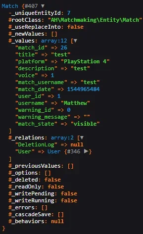

Directly below your <div> type {{ dump($match) }} then inspect the result, that should tell you why.
Also, your contentcheck in this case is useless since the $match.voice check will always return some amount of text. It will always print either "has a mic" or "does not have a mic", so there will always be content inside the <ul> :)

Can you show me the getStructure function from the AH\Matchmaking\Entity\Match file? There might be something else going on here but I'm not sure 🤔
Fillip

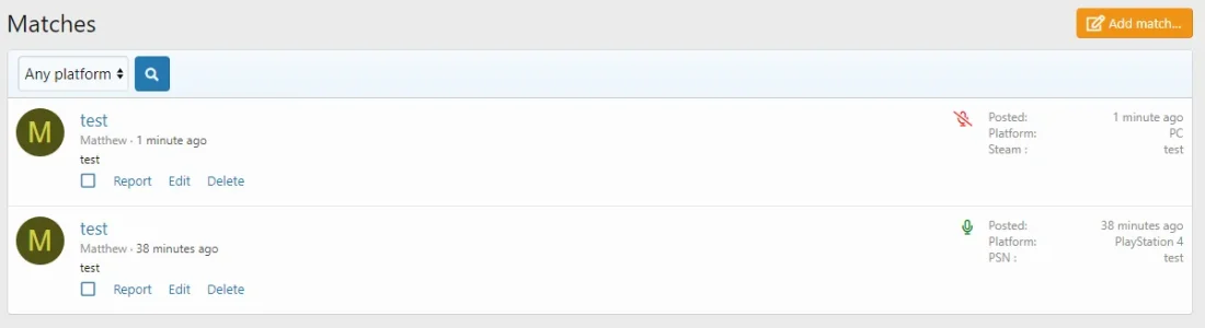

Oh actually it was working, I was just using the wrong syntax for the font awesome icon,. microphone instead of fa-microphone
All good now (: Thanks Fillip
