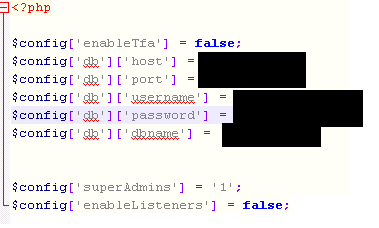

I've also tried disabling listeners in the config, it didn't seem to help, but I'll try again.
EDIT: Nope still not working.

I believe this is correct?:
