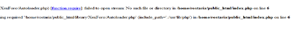

I decided to move host and followed the instructions here, however I keep getting a fatal error. I have refreshed my cookies, restarted the server and now I am stuck. Help would be appreciated.
I have uploaded all the files I doubled checked, but I am still getting the same error. I downloaded all the files last night and backed up the database. It seems to have not worked.
Check if this directory home/rostaria/public_html/library/XenForo/ exists and if it includes a file called Autoloader.php
It looks like not all the files downloaded properly. The host was acting weird last night. Everytime I tried to download anything it would time out and disconnect. Now it appears when it did work it didnt download all the files properly.
