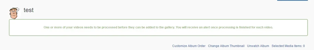

I installed the newest version of MG on the newest version of Xenforo. My host installed the ffmeg on my VPS. When attempting to upload a 11 second wmv movie from my computer I received a message to the effect that the video could not be processed and to try another video. I adjusted the path to PHP which allowed the movie to be uploaded and also created a thumbnail. After this is said the video needed to be processed and I would receive notification when complete. I am not receiving any message and the video is not being display and so I think not created? I would think that because I saw a thumbnail after uploading the video that ffmeg was doing what it is supposed to although I do not know that to be a fact.

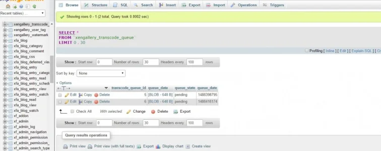

Delete the two entries from the transcode queue table and then try to upload one of the videos again. Does it move into the "processing" state at all if you look in the database?

I deleted the two entries and then uploaded the same 11 second wmv something like 16 MB . That file is now in the queue that I just cleared.
