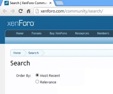

What I'm proposing is an add-on (that I will be developing soon, ad manager is still my highest priority), that will display a new sub menu under Forums called "Top Content".
I don't like the idea of hiding the Top Content. I think you should use the default search box (or at least the option to do so).
The quality score will be determined with a formula that I'm not entirely sure of at the moment. I plan to take into account the posts age (as it's still relevant), the # of likes received, the # of views and replies (only applicable to threads).
That might be similar to Xenforo's Search addon that has "Relevance".
I could modify the search system I suppose but I wasn't really planning on hiding the Top Content, it was going to be right next to the New Content (New Posts).
One thing for you to study is .... comparing forum searches with a google search of the site. Google almost always provides more useful searches.
XenForo's search does seem pretty good by default, every time I use it I find what I'm looking for. It just seems old, high quality content does get lost. When I'm trying to find the next add on I want to make I check a few boards (custom requests, requests, and suggestions being the main ones). If I don't find something on the first page then I get discouraged and make something random (Promoted Content, Posts Per Day, Notable Members [the most followers tab part of it, the caching and recent activity parts came from suggestions] are my random ones, Hashtag, XMWidgets, and my others are from requests and suggestions). If there was a link where I could view "Top Content" which showed me the threads with the most quality activity (based of user engagement (likes and replies), lots of views with no likes or replies is a sign of a bad thread) then it'd save me effort + result in more desired stuff).
